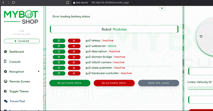

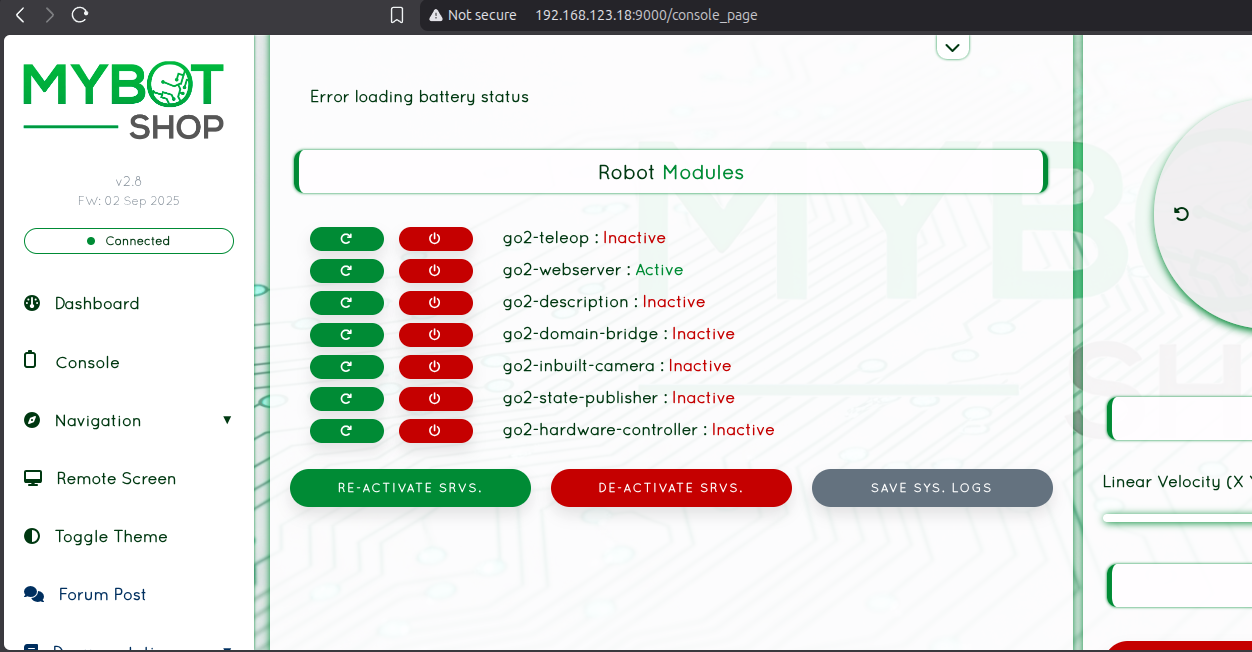

2. bag-info_domain10_launch.txt
Recorded with:
ROS_DOMAIN_ID=10
This was recorded directly after launching the robot, without manually activating additional modules in the MYBOTSHOP web interface.
At this point, only a small set of topics is visible, such as:
  • /go2_unit_38712/client_count
  • /go2_unit_38712/webserver/cmd_vel
  • /go2_unit_38712/e_stop
Most robot modules are initially inactive in the web interface, as shown in the attached screenshot webview_modules.png.
We attached the following files:
  • bag-info_domain0.txt
  • bag-info_domain10_launch.txt
  • bag-info_domain10_all-modules-active.txt
If you need the full rosbag files, additional screenshots, SSH outputs, service logs, or a live topic/node dump, we are happy to provide them.
