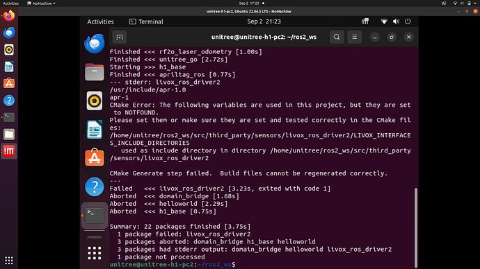

I’m trying to use the h1_bringup package for the Unitree H1 robot, but I’m running into build issues related to missing dependencies. Here’s the full sequence:

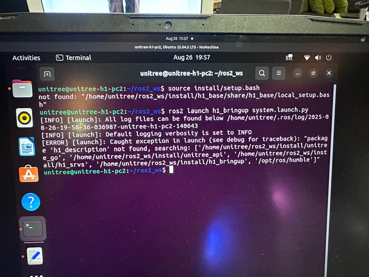

  1. When I try to build h1_bringup, I get an error saying:
    h1_description not found
  2. So I tried building h1_description, but that gives me another error saying:
    h1_base not found

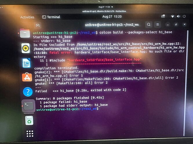

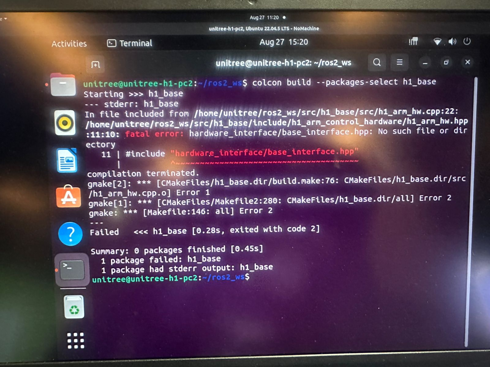

  3. Finally, when I try to build h1_base, I get the following error:

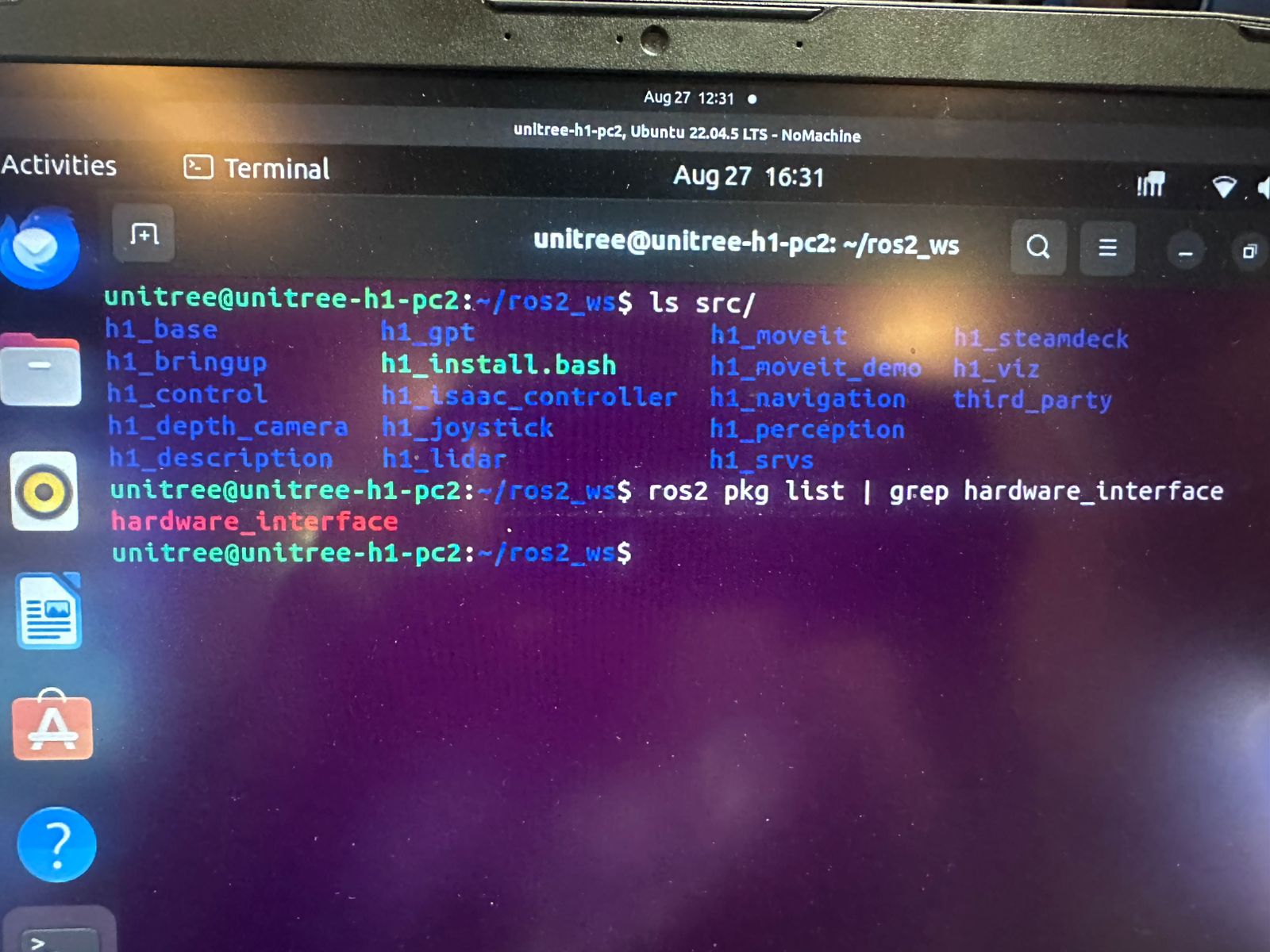

    “hardware_interface” not found, even though I already have the hardware_interface package installed.
I’ve confirmed that ros2_control is installed, and I can use other packages that depend on hardware_interface without issues. My ROS 2 distro is humble.
Any idea what might be going wrong? Am I missing a specific version or dependency?
Thanks in advance!

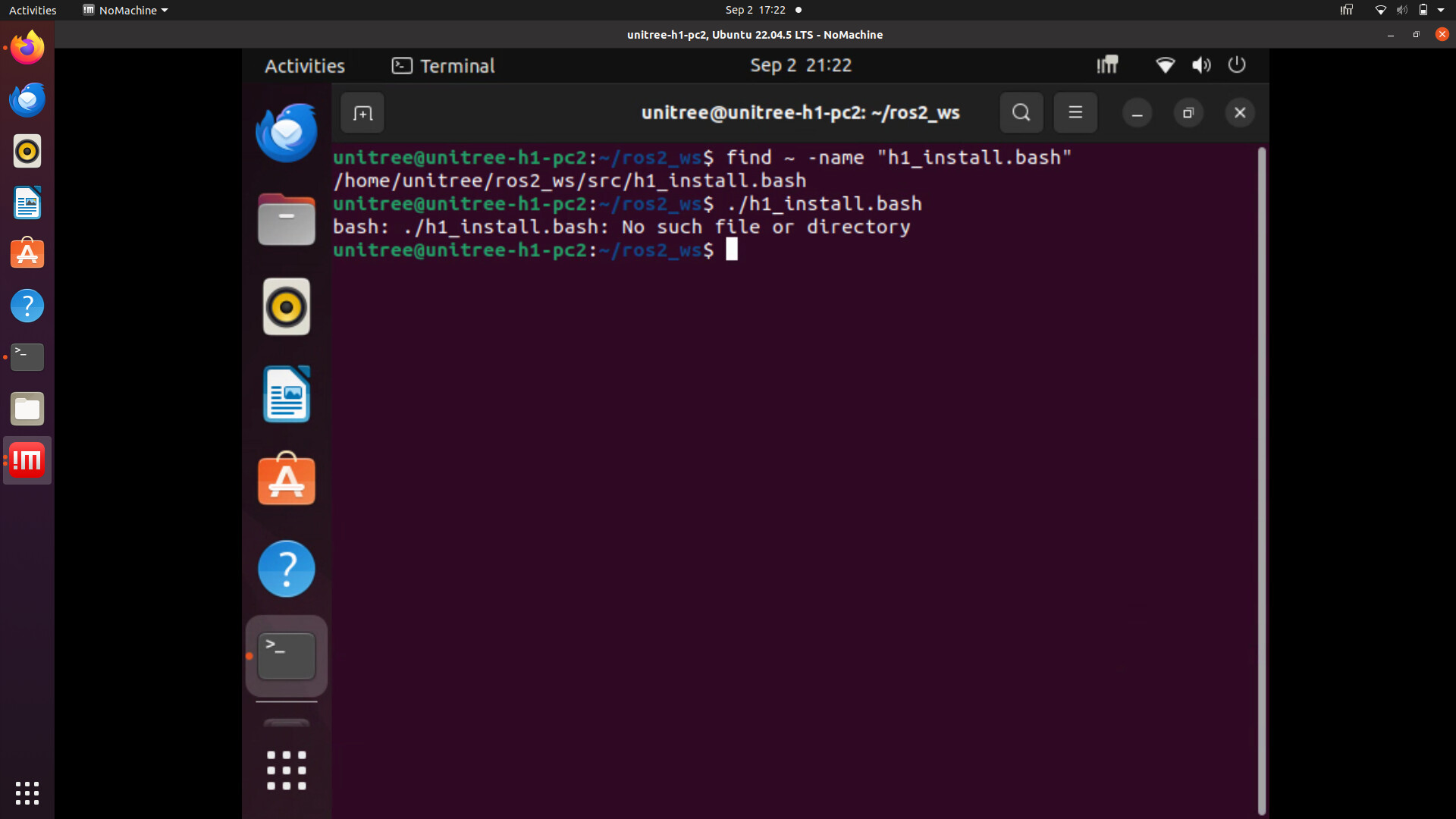

  • cd into the h1 directory and run ./h1_install.bash

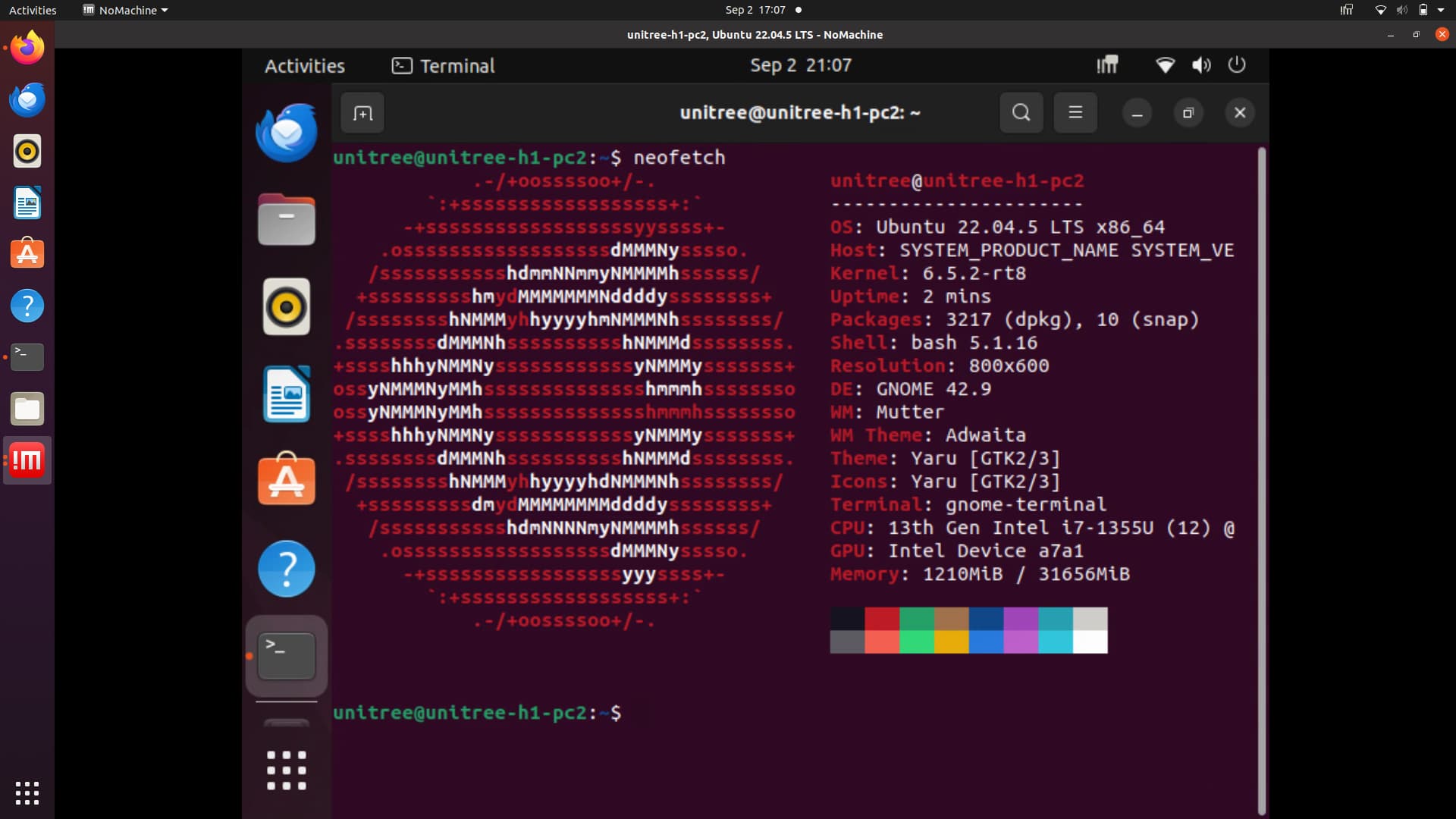

Could you confirm via neofetch if the H1 is in ros2_foxy or ros2_humble. If it is in ROS2 Humble then the current repository is not applicable.
Hi Sohail,
Although /h1_install.bash is there i cannot run it and when i build it will build most packages except 8.
Furthermore, I ran neofetch on the H1 PC2 onboard computer, but it didn’t show the ROS distro in the output. To confirm, I used the rosdistro command instead, and I can verify that the system is running ROS 2 Humble.
Let me know if you need any additional details.
Best,
Nasser
You are in the wrong directory
cd /home/unitree/src/
./h1_install.bash
It is ubuntu 22 so the ROS2 foxy may not work and is not tested with this version. We will update it in in the coming months.
