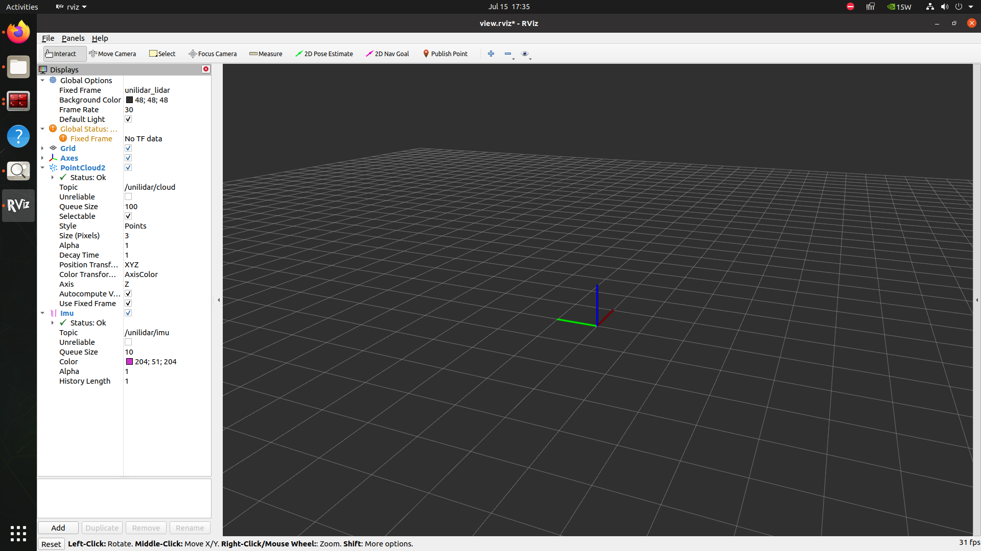

i am facing some issues with accessing the the LiDAR of the Unitree go2w. Here i have setup all the sdk for the lIDAR and after running the launch the rviz will get launched but there wont be any liDAR projections showing in it.When i checked there is some issues with the publisher and subscriber part.
could anyone help me to solve this part.

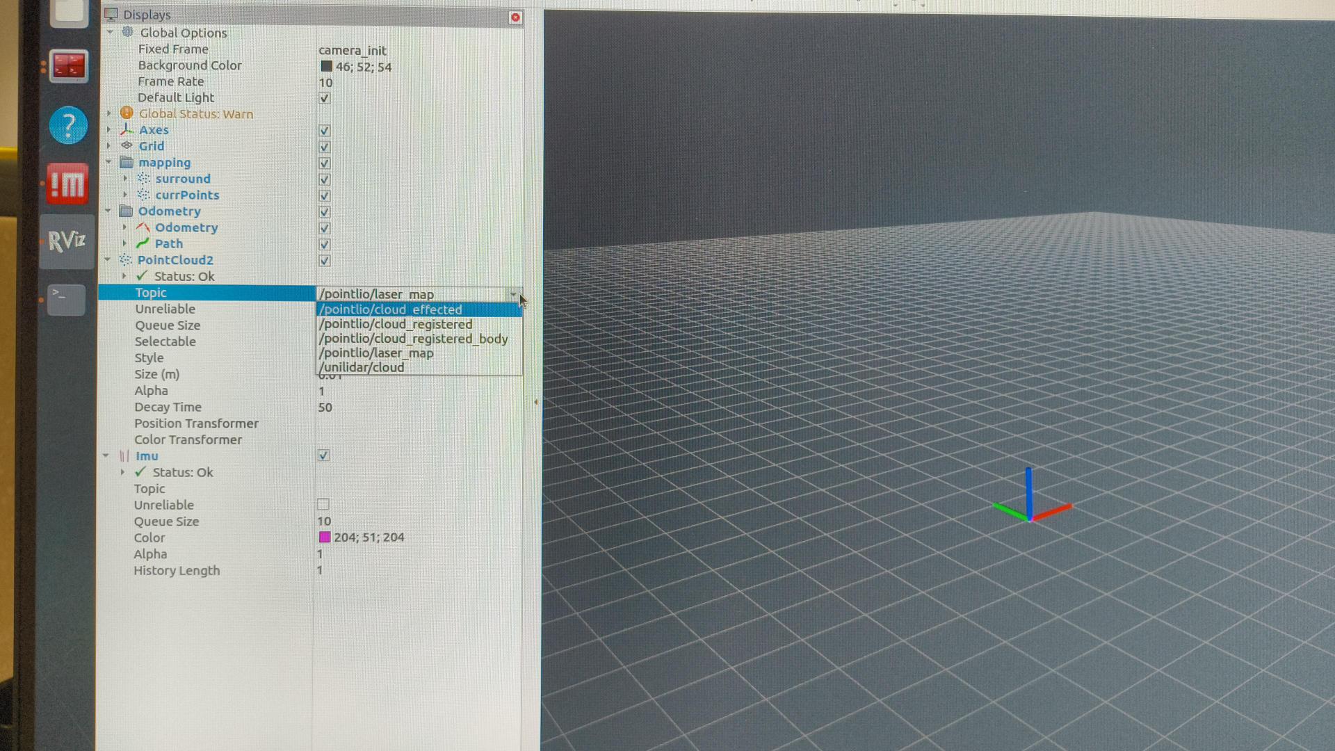

when i was launching the the “point_lio_unilidar” using the command, the Rviz is getting launched.
also when i tried to contact with the Unitree support and was explaining the error i am facing they are saying that the
“livox_Rviz? That’s for mid-360.
Not L1
We didn’t give tf-data in the rviz.
You have to set by yourself.”
so wont us be able to use it in Rviz?

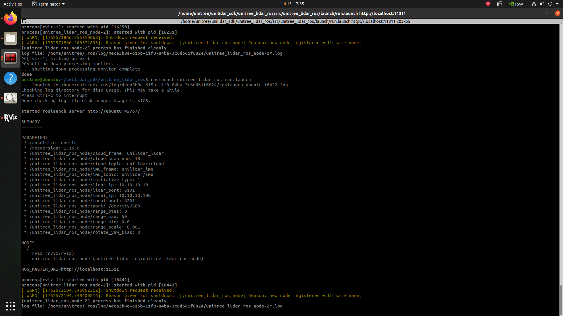

Despite the launch completing without error, I am unsure whether all the required ROS topics are being published and subscribed to correctly, especially with respect to:
  • Point cloud data
  • IMU data
  • Odometry
  • Path
  • TF frames
Current Node Graph
From the output of rqt_graph, here’s the current state of the system:
Nodes:
  • /unitree_lidar_ros_node
  • /laserMapping (from point_lio_unilidar)
  • rviz
Topics Published:
  • /unilidar/cloud
  • /unilidar/imu
  • /tf
  • /pointlio/cloud_registered
  • /pointlio/odom
  • /pointlio/path
Connections (from rqt_graph):
  • /unitree_lidar_ros_node → /unilidar/cloud, /unilidar/imu, /tf
  • /laserMapping (aka point_lio) subscribes to: /unilidar/cloud, /unilidar/imu
  • /laserMapping publishes to: /pointlio/cloud_registered, /odom, /path
However, no TF data appears for camera_init, and RViz displays nothing even when subscribing to these topics.
The unitree go2w doesn’t provide tfs.
So what should I do to get the lidar sensor mapping
can anyone please help me out with problem.

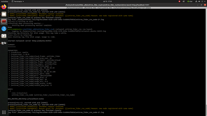

It seems that you are running the same node twice from the picture.
After running the driver try echoing the topic and see if data is coming.
