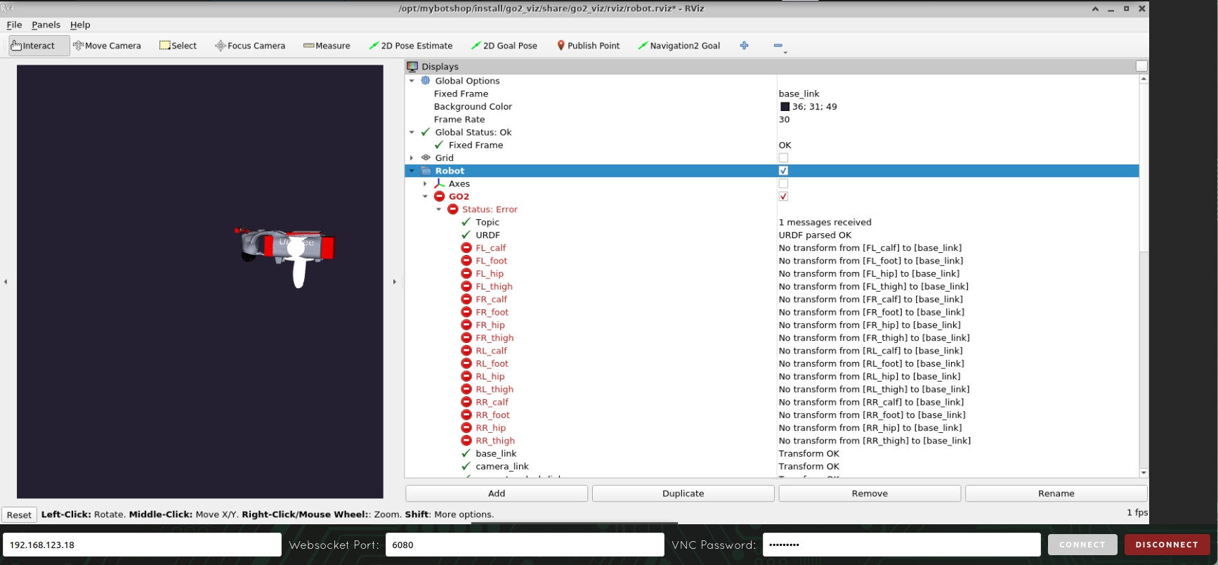

We also connected via the Webserver VNC and successfully launched the ROS 2 files for SLAM, Odometry, and Map. Despite this, the SLAM and odometry nodes are publishing Transform errors for the /map and /odom frames. Additionally, RViz shows an error on the /go2_xxxx/robot_description topic because the transforms for the legs are not being published. Crucially, the /joint_status topic remains empty, despite having a publisher and subscriber.

The drivers of go2 are not running. Once you have access to the go2 repository. Please follow the instructions for running the go2. The Go2 TF’s should work regardless when you are at base_link.
