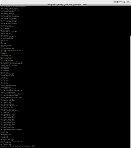

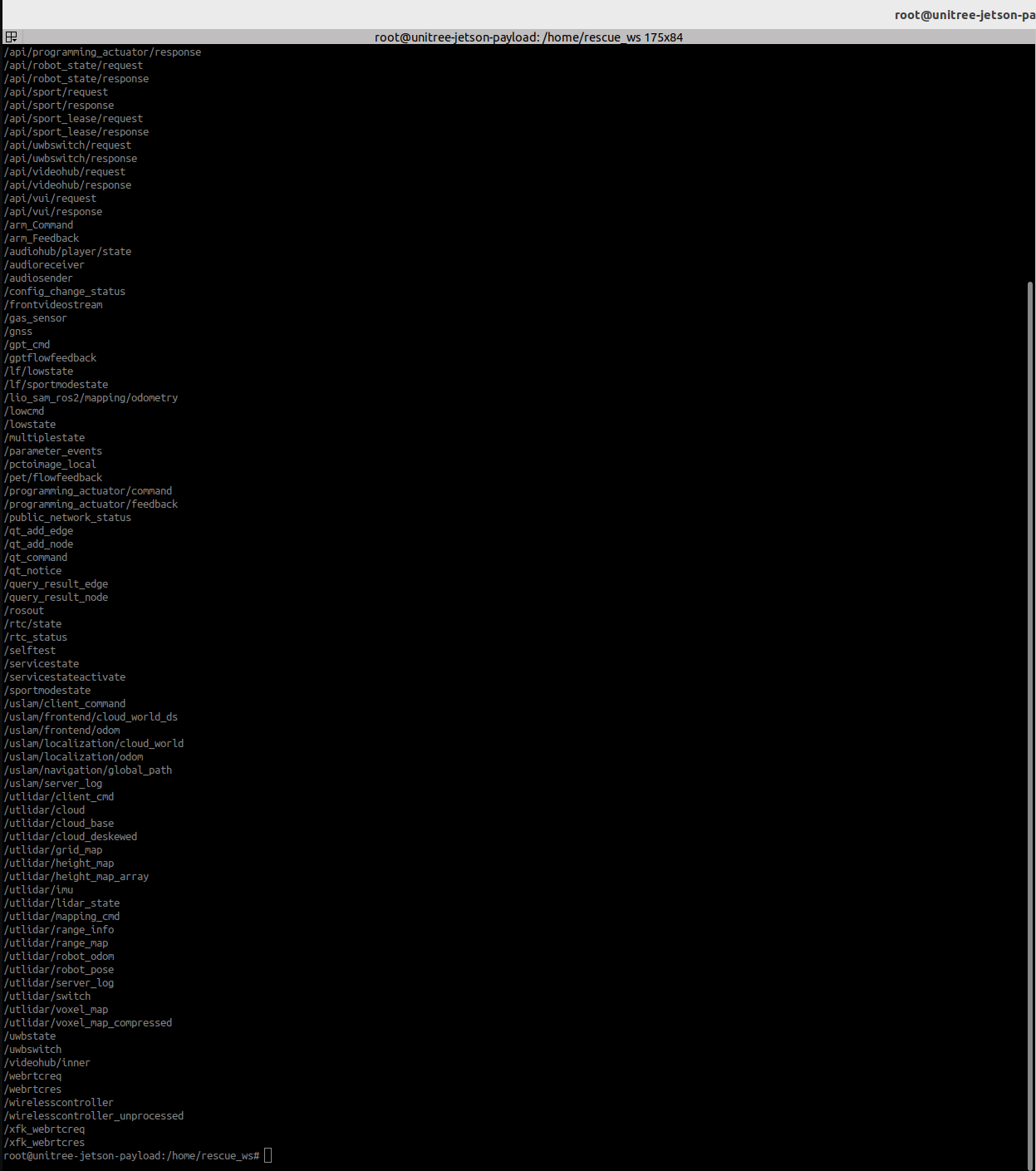

I am having a problem with LiDAR in chin i see the topics of the LiDAR but not all topics are working the only ones working are /utlidar/cloud and /utlidar/imu the rest are not working.
This is “ros2 topic list”

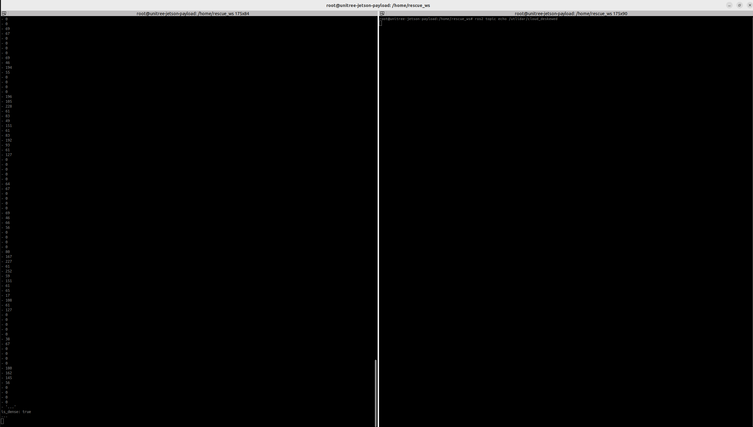

This is “ros2 topic echo /utlidar/cloud” on left side and on right side “ros2 topic echo /utlidar/cloud_deskewed”
Hi,
The reason is that different versions of go2’s have different firmware and default GO2 legged ones have the deskew topics .The Unitree GO2-W doesnt have it and if you want to deskew it you can update the URDF link and it will be ajusted from there.
