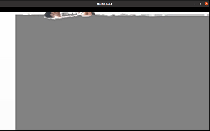

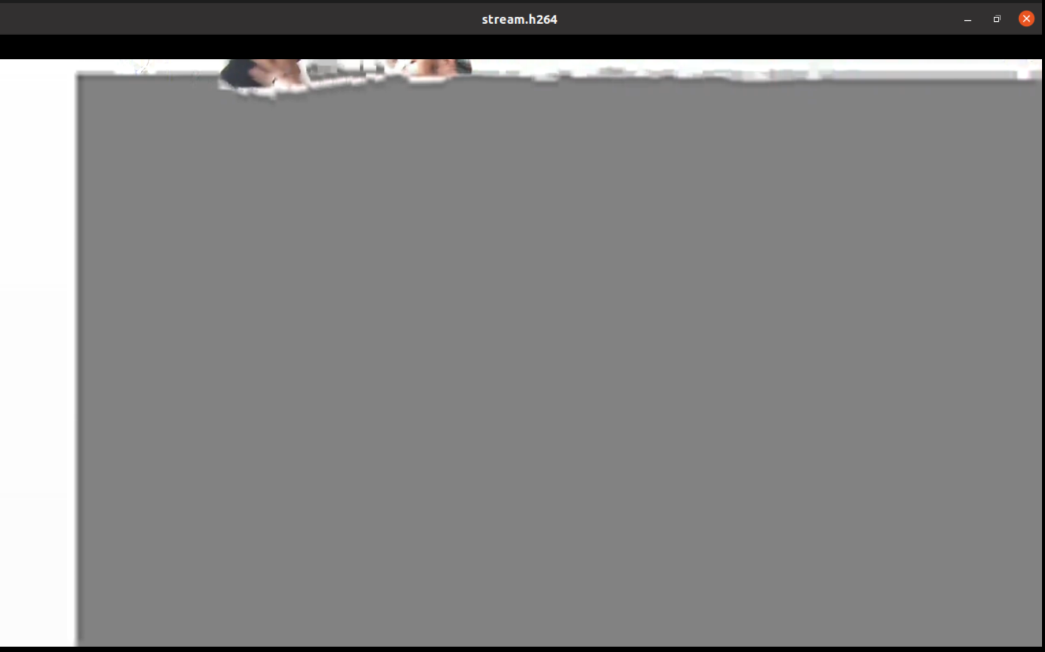

I’m trying to get it running, but I’m not sure how to interpret the data inside the Go2FrontVideoData message, especially the video720p array:
The frontvideostream type is unitree_go/msg/Go2FrontVideoData
uint64 time_frame
uint8[] video720p
uint8[] video360p
uint8[] video180p
I tried concatenating video720p packets directly into a file and playing it with ffplay. The result is only partially correct: I can see some content, but only the top rows of the image render properly (see screenshot).

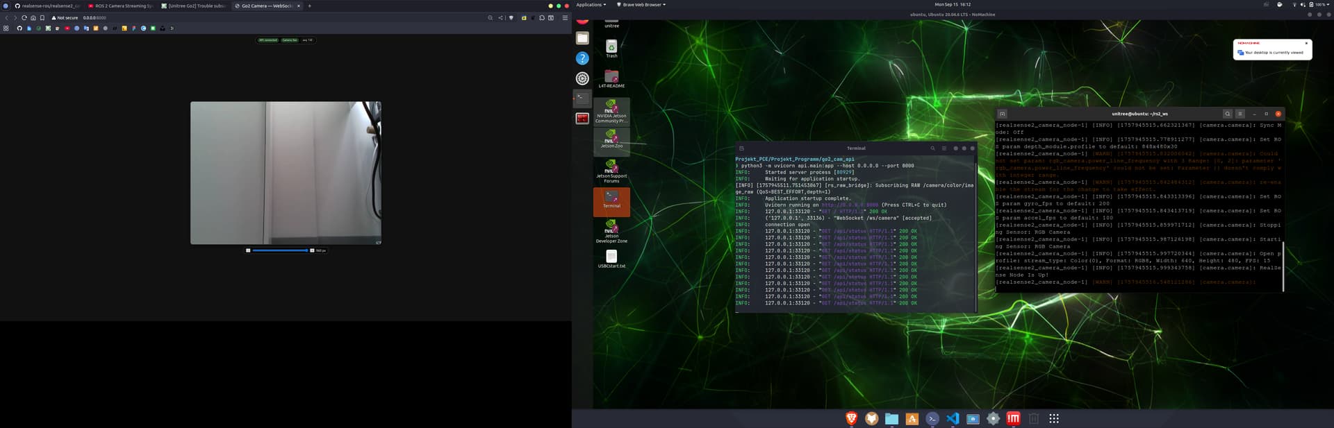

Hello everyone,
I initially tried to access the Unitree Go2 inbuilt camera topic (/frontvideostream) but ran into serialization and performance issues, so I switched to using an Intel RealSense camera instead. The RealSense feed is republished on ROS 2, compressed with TurboJPEG, and streamed through a FastAPI WebSocket endpoint. On the frontend, a lightweight HTML/JS page renders the frames on a canvas with resize controls and status pills for API and camera state. To avoid lag, the ROS subscriber uses QoS BEST_EFFORT with depth=1, so only the latest frame is displayed. For reliable communication I had to set RMW_IMPLEMENTATION=rmw_fastrtps_cpp and a common ROS_DOMAIN_ID between the Jetson (publisher) and workstation (subscriber). First when I tried with Cyclonedds it gave std_bad_alloc (memory allocation) error, but after testing it today again on RMW_IMPLEMENTATION=rmw_cyclonedds_cpp it worked fine.
