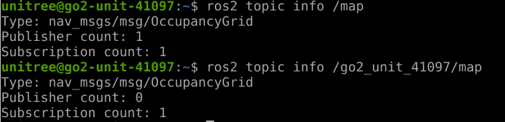

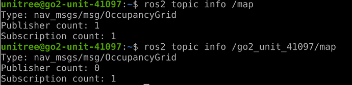

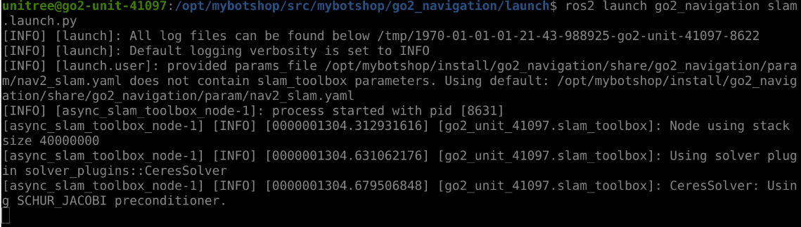

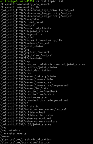

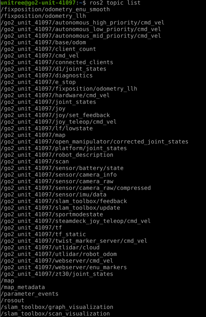

Here are several screenshots I have made. As you can see I started the slam launch file and then I can also see both map topics.
With topic info function I have found that no node is publishing in the go2_unit_xxxx/map so as a result there is also no messages in both map topics. Is there a failure in launch file or the yaml file that I should or need to change before launching slam? Many thanks in advance!

Can you check if there is data coming in the scan topic itself?
There is also no publisher
topic_scan
The laser scan is not coming the. Is the Lidar points coming is the pcd_to_laserscan launch file working. This has to come first.
