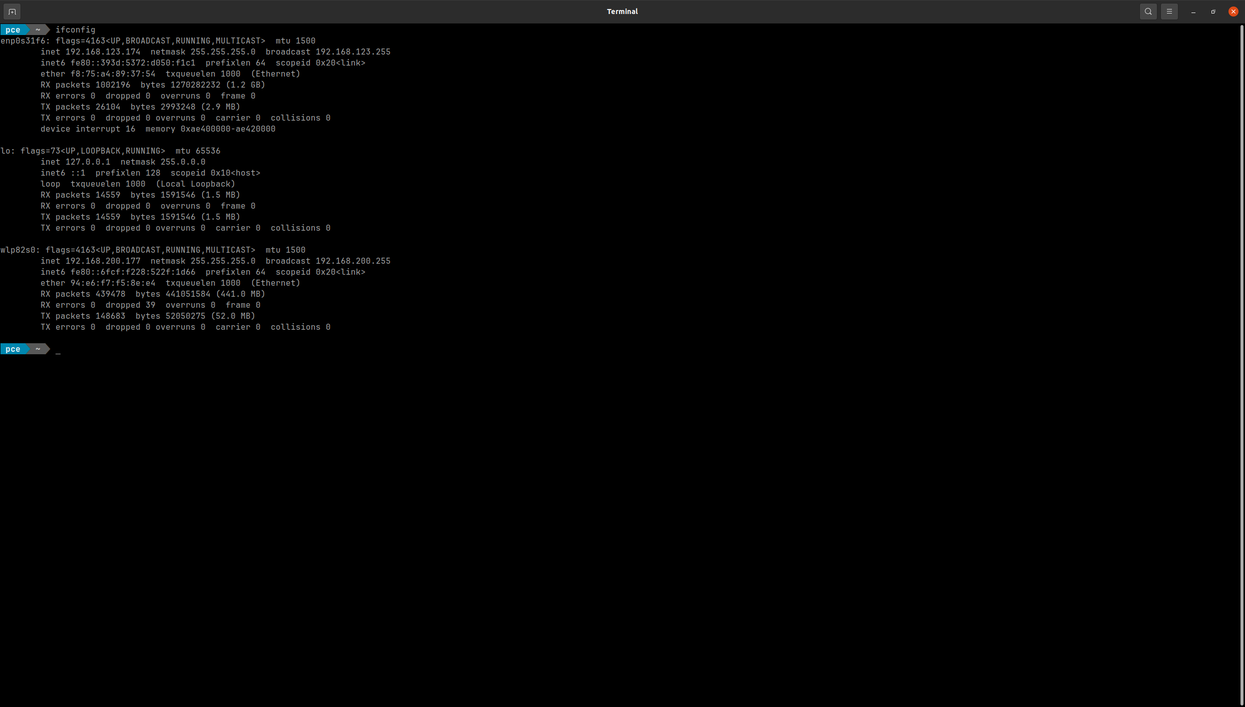

Also, please share your
ifconfig

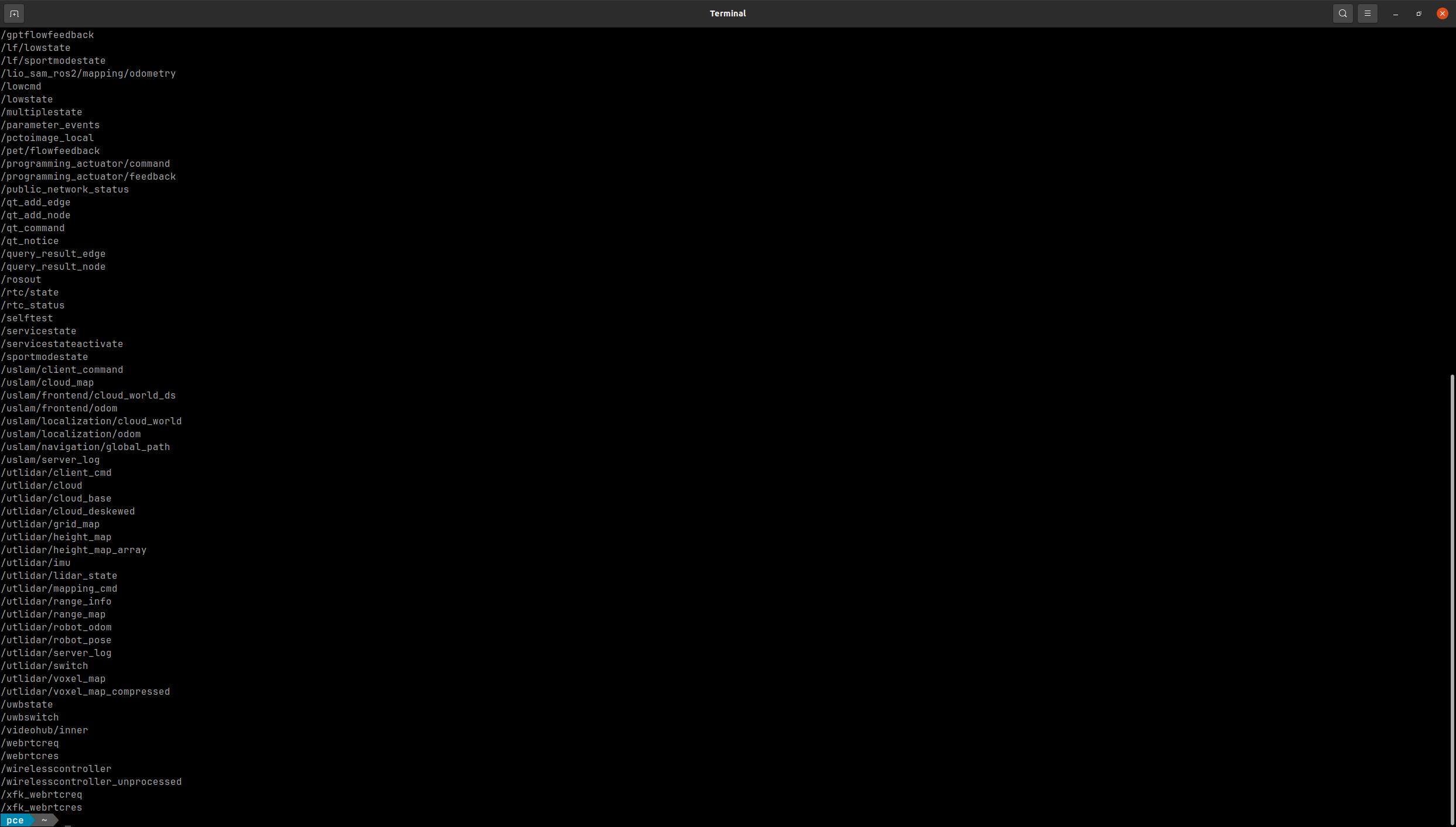

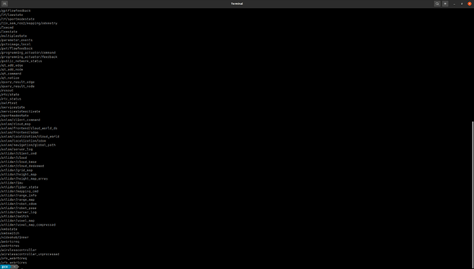

the export command worked. I am able to see all ros2 topics. Thank you.

Here is my ifconfig snippet, if possible can you help me with wireless connectivity, I am sure I have to change the interface name from enp0s31f6 to wlp82s0
