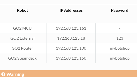

Could you confirm that you have set your own IP to static e.g. 192.168.123.51?
i haven’t since its not on the instractions
Hello again,
I followed the guides and got the IP : 192.168.123.51, BUT still I cant access the go2 router and the go2 steamdeck via the IPs you mention on the table

Is your go2 with the ROS2 Steamdeck, if so please follow this
https://www.docs.quadruped.de/projects/go2/html/go2_driver.html#go2-steamdeck
