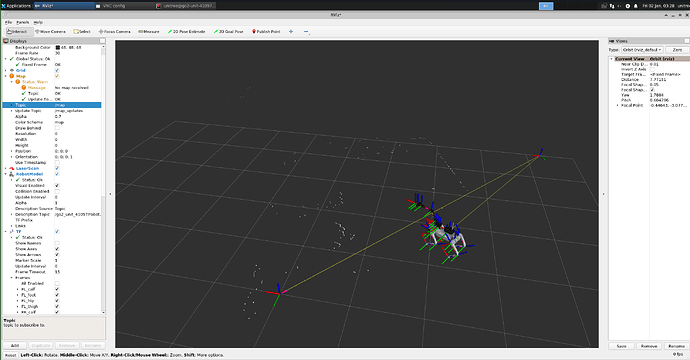

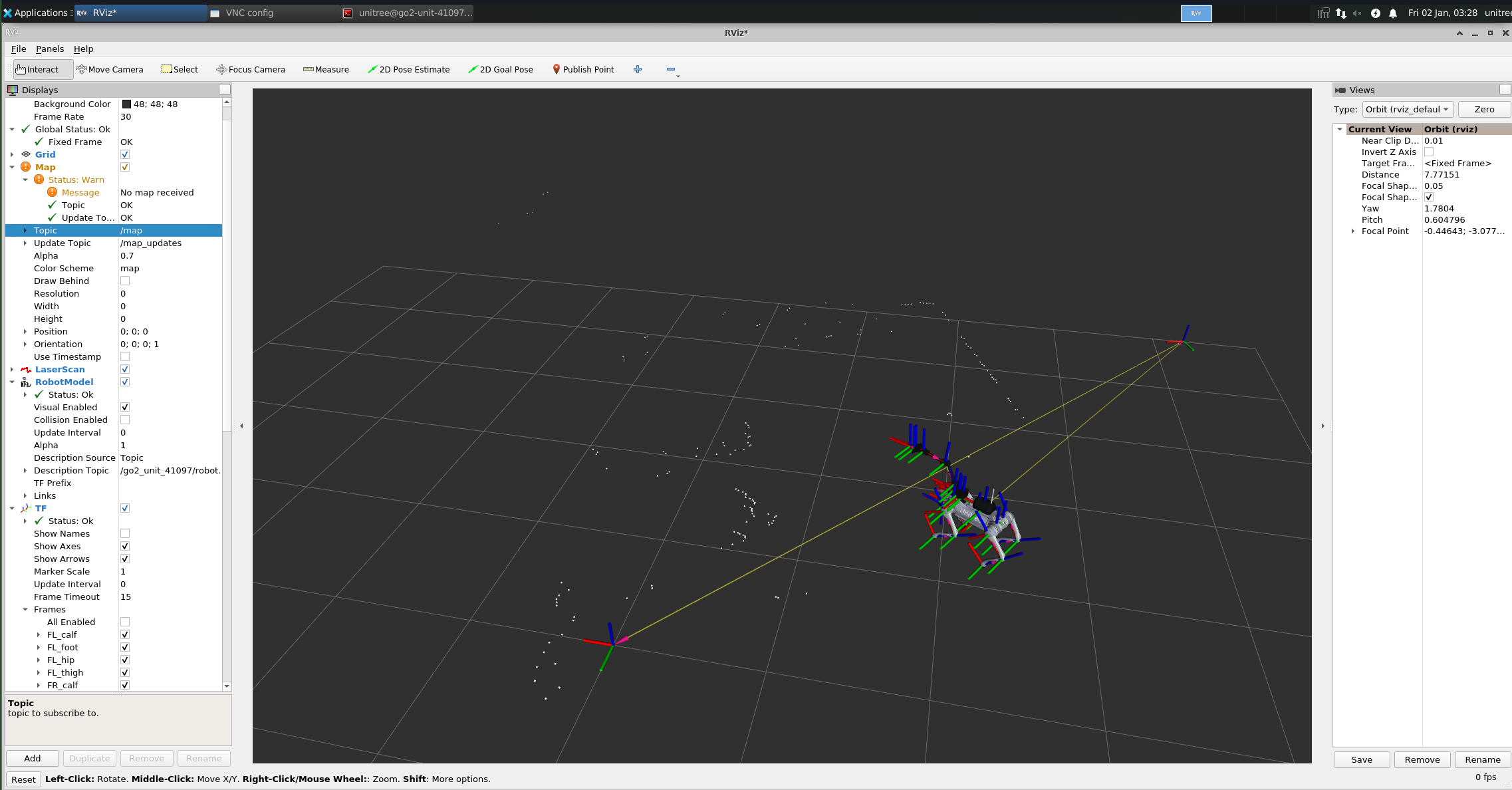

Hi, I have a problem with navigation. After saving the map and rebuilding the workspace, I want to start navigation.
So I started three nodes, one starts the laserscan node(which also enable the robot model to be seen, the tf between robot model and map is given) in go2 platform. The second starts map_navi.launch.py in go2_navigation and the third is a rviz. However the map is not shown in the visualization. How can I be sure the correct map is choosen? As is mentioned in the maual, if the map has been named something other, the parameters needs to be updated. But how and where should it be done? Because I have found nowhere in launch file and param file. Thanks a lot in advance!

Okay, but I have checked the map_navi.launch.py, which contains localization and navigation.launch.py.
But I have checked localization.launch.py and its param file nav2_localization.yaml and have found nowhere to change the map file name.
I have also found that the visualization can be started instead of rviz2 by ros2 launch go2_viz view_robot.launch.py

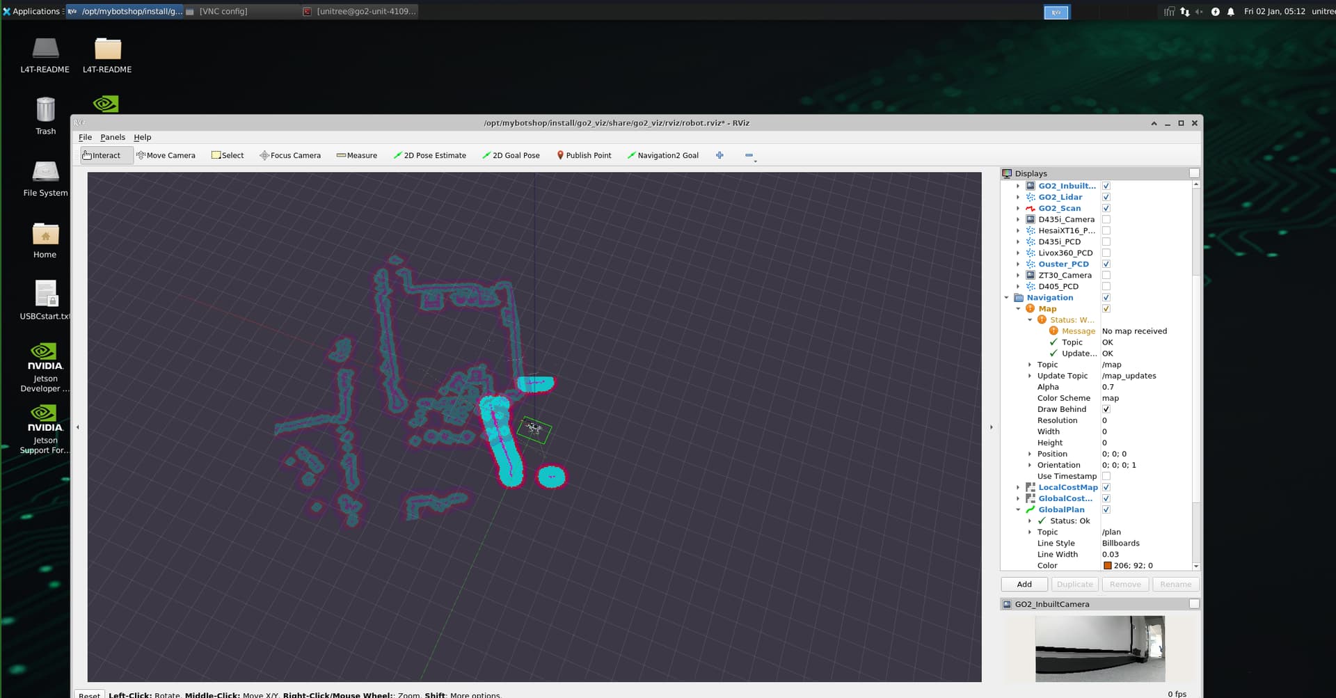

Thanks for your code. I have just checked with runnning map_navi.launch or both localization and navigation.launch. They will show in RViz with the Global Costmap, which are the darker purple lines. They are also the same as the map I have saved under /maps/custom_map.
The map is also called because
    'map',
    default_value=os.path.join(bringup_dir, 'maps', 'custom_map.yaml'),
there.
However in topic /map there is always no map published. And also the localization is not working. As far as I know about amcl, the robot position will calculate and move in the map until it gets the correct position. But here is not.

For initial pose, it has to be namespaced in the rviz2 launch file otherwise it wont relocalize.
It will come in the namespaced one and once when first time loading as it is not continuously published.
