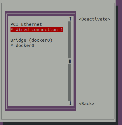

Once you connect the WiFi stick, do:
sudo nmtui
Activate connection and connect to your WiFi network.
I have not found the wireless USB adapter here. I am using the TL-WN722N(EU)Ver4.0 with S/N:2249E5004521. And I am not sure, is this also plugin usage available for Ubuntu or something extra needs to be installed first.

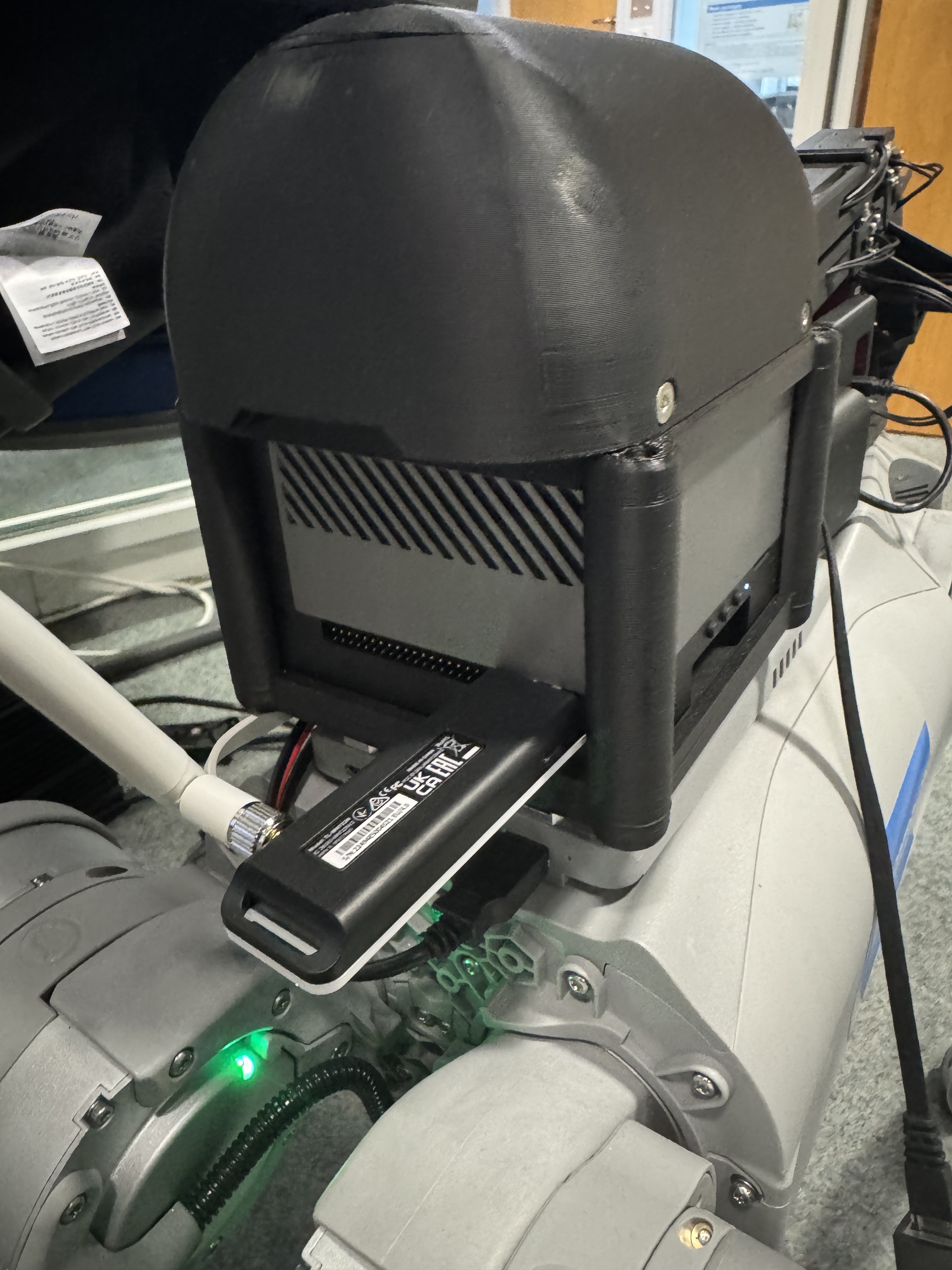

I have connected the WiFi dongle to this port.IMG_0256|375x500
You connected to the Jetson. You should connect it to the USB hub above or directly to the computer.

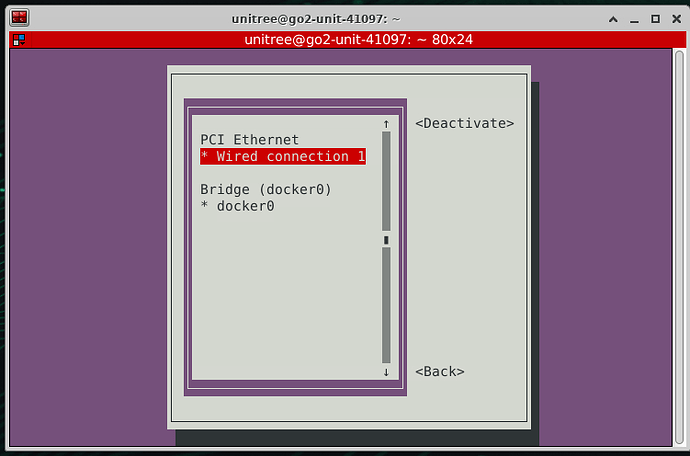

I have plugged the WLAN dongle into the upper white box with GL-iNet but I can still not find a new connection here.

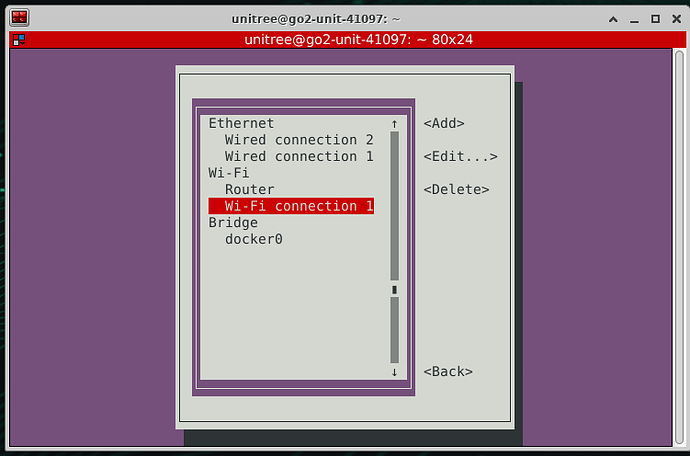

I have also configured a wireless connection here
Try connecting directly to the GO2 also ensure that you connect it before powering on the Go2.
Okay it works when I plug in directly the port on Go2. I can connect see the internet connected to Go2. However the port was used before and I think was connected to the Open Manipulator.
