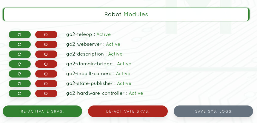

I had installed the qre_go2 repo on our Go2 EDU.

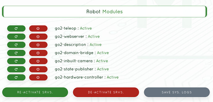

From now on, I can access to the webpage and see that all services seems to run correctly :

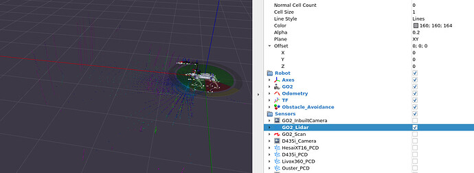

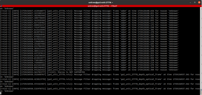

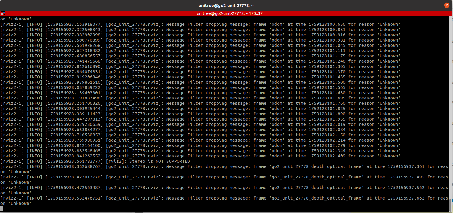

But when I wan to try the “robot viewer”, I get too much warning message on the console from internal lidar :
ros2 launch go2_viz view_robot.launch.py

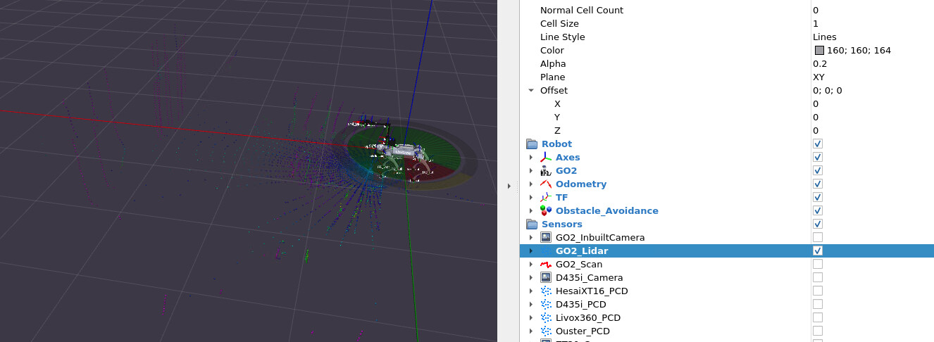

And no point cloud :
The only points displayed are from the GO2_Scan topic
Even the point cloud from the D435i are not displayed. (while it’s camera can be displayed)
What could be wrong ?

  • Are you viewing the rviz2 on an external computer or within the unitree go2’s computer
    • If so try using vnc and viewing from the internal computer
  • Have you tried echoing the topics?
    • Ensure you are in ROS_DOMAIN_ID=10 when doing so
  • Have you tried enabling the RViz2 tick boxes for all the sensors?
    • Did you click enable on the tickboxes for the sensors, it seems the PCD pointcloud ones are unchecked.
  • Try restarting all the services with RViz2 already open
  • Ensure that your external computer has only one network enabled that is connected to the Unitree Go2
This is both for the point cloud and the d435i.
  • All my test were done from the internal Nvidia computer.
    I attached screen and keyboard to the robot.
  • It’s not working also with the ROS_DOMAIN
  • All tick box didn’t change anything

May it be a problem related with the clock ?

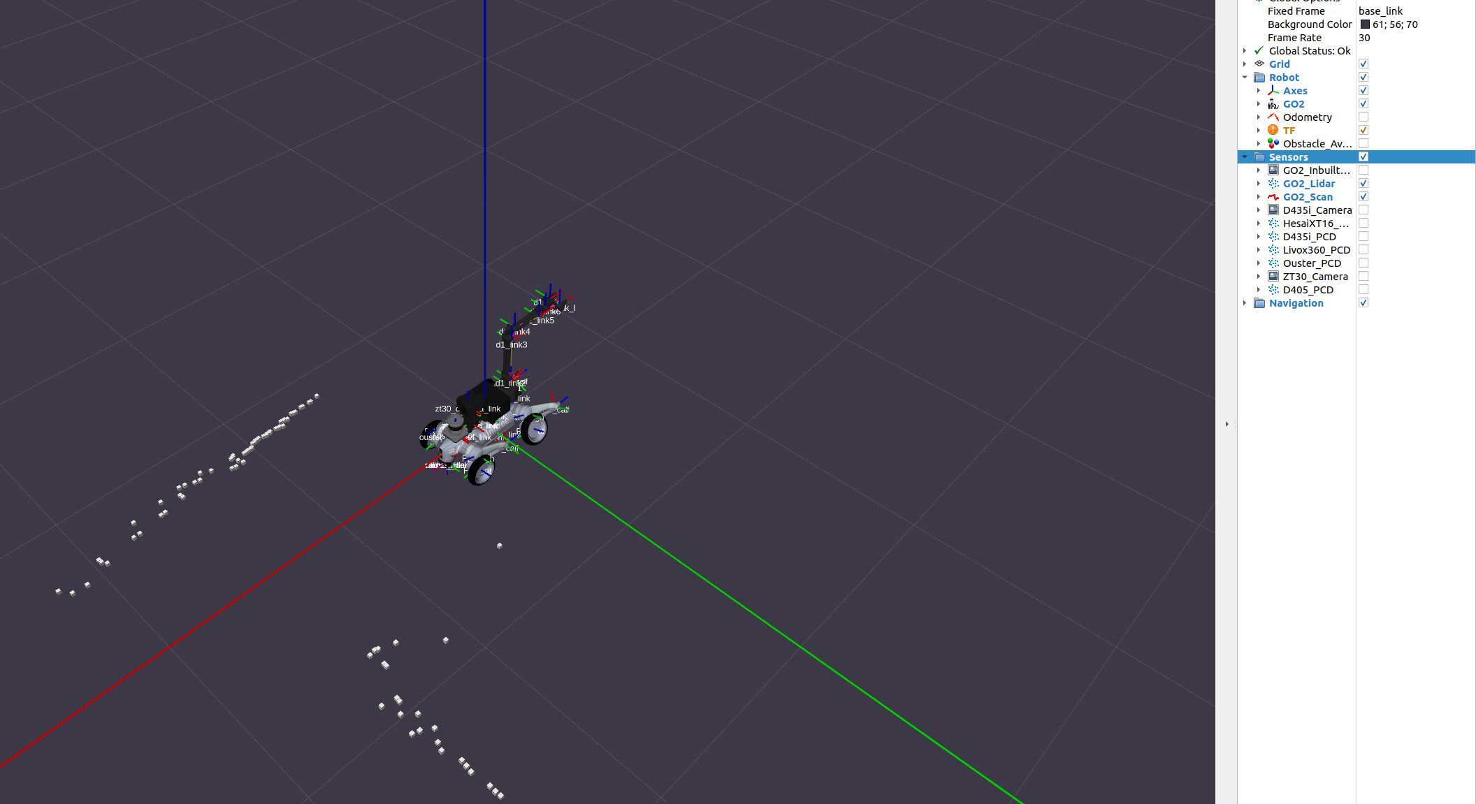

I managed to make the lidar works 2 times, without changing anything in the config.
The only things I do was to plug a USB/Ethernet dongle and the jetson to the Internet so the jetson computer has a correct time.
Currently the robot is only connected thru USB-C to a dock with a screen and a keyboard so each time it boot, the date is reset to 1970
We finally purchased an USB/Wifi dongle.
From now on, point cloud is working :
I really think it’s a time desynchronisation that make embedded computer reporting different timestamp to the nvidia computer (wich didn’t had access to the internet), and one transform makes the point cloud not working.
