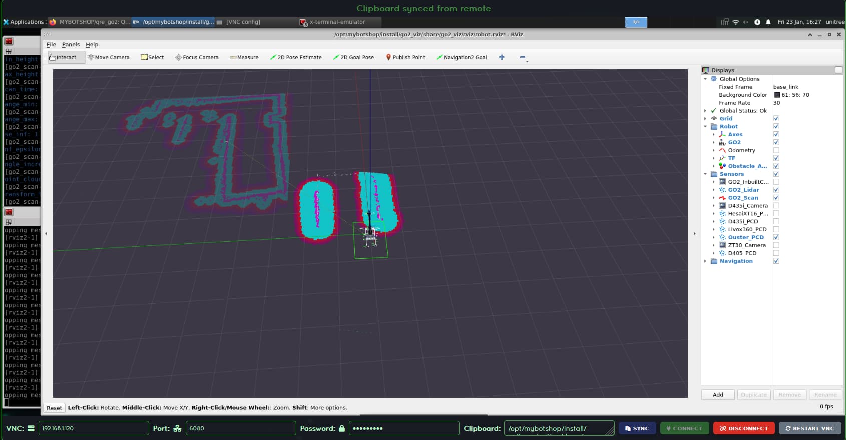

I’m working on Unitree Go2 using ROS 2 Foxy with the Nav2 navigation stack for autonomous navigation.
SLAM is working so far, and I can also see the map when I start navigation.
However, when starting, the robot positions itself directly outside the map. When I try to reposition the robot in RViz with 2D Pose Estimate, nothing happens or RViz crashes.

Could you please confirm if the rviz is adding namespace to the 2D pose in the launch file. Most probably, it is something related to that.
RViz does not add a namespace to the 2D pose estimation. It is published under /initialpose.
It requires nsp then. Simply add nsp tag in rviz launch files remapping to apply the nsp.
I added a remapping. The problems remain the same, but a different error code is displayed in the logs.
[rviz2-1] [INFO] [1770634888.999940064] [go2_unit_14082.rviz]: Message Filter dropping message: frame ‘odom’ at time 1770634022.946 for reason ‘Unknown’
[ERROR] [rviz2-1]: process has died [pid 19111, exit code -11, cmd ‘/opt/ros/foxy/lib/rviz2/rviz2 -d /opt/mybotshop/install/go2_viz/share/go2_viz/rviz/robot.rviz --ros-args -r __node:=rviz -r __ns:=/go2_unit_14082 -r /tf:=tf -r /tf_static:=tf_static -r /initialpose:=/go2_unit_14082/initialpose’].
