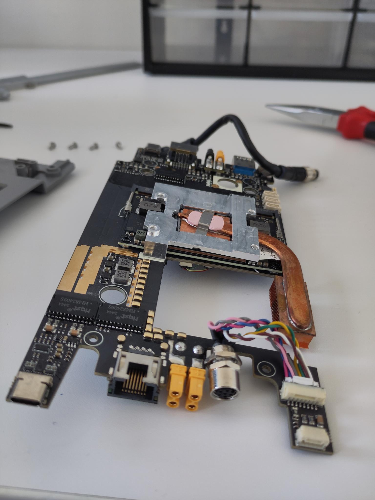

Can someone explain why the connector for the Livox mid360 is doing this U-turn and ending in another connector? Should this connector not be connector to the Jetson? I am confused how this is supposed to work.
@Noor Could you perhaps assist on this.
Got any update? @Noor
How does it look like for other users? Do they have an external connector?
Dear @Silas_G,
The board in this setup is a carrier board for the NVIDIA Jetson, so the Livox Mid-360 connector is already connected correctly through it.
