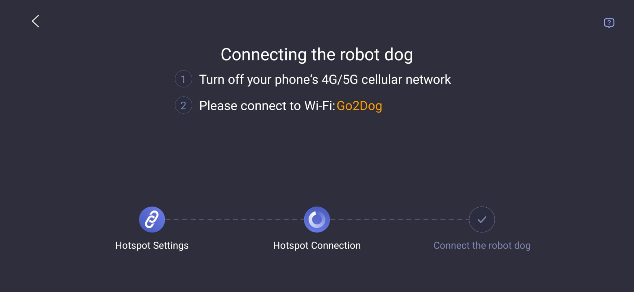

I have issues to connect to the Unitree Go2 via the app. I tried it on two devices, but face the following issue:
Whenever I try to bind the robot in the app, I only get to the point where one aims to connect to the robot dog. It asks me first if I want to connect to a temporary hotspot, which I can also verify in my Wifi settings (it says connected via the Unitree Go app), but it is stuck at the hotspot connection step and nothing happens:
At this point also a regular Wifi hotspot shows up in the list of Wifis with the same name, to which I can also connect. But returning to the app shows that it remains stuck at the hotspot connection step.

Do you refer to the newly configured hotspot on the robot? Just to clarify, I aim to use the AP Mode. I indeed see the newly created hotspot and can connect to it instead of the temporary. But as I wrote in my initial question, also after connecting to the newly created hotspot, I am still stuck on the Hotspot Connection step as indicated in the earlier image.
When I abort this after some time, I can also see that the dog is binded, but I cannot actually connect to it to access any settings, perform IMU calibration etc.
