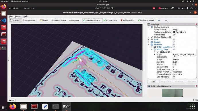

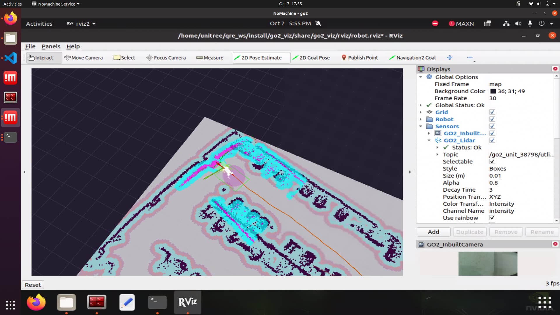

I’m working on Unitree Go2 using ROS 2 Foxy with the Nav2 navigation stack for autonomous multi-goal navigation.
The robot successfully navigates to the first 2D goal, but when I send a second or subsequent goal, several issues arise. Sometimes the robot fails just before reaching the goal, and in many cases, I need to restart map_navi.launch.py to regain navigation functionality.
Additional critical observation:
  • After the error occurs, the TF tree stops receiving updates.
  • As a result, the URDF visualization in RViz turns completely white, indicating the robot model is no longer receiving pose or transform updates.
This makes multi-goal autonomous navigation completely unreliable.
This has become a critical problem for executing sequential navigation tasks. I’ve tried multiple fixes but the issue persists

Observations:
  • The first goal completes successfully.
  • Errors typically occur when the robot reaches or is near the second goal.
  • Control loop warnings indicate the controller_server cannot maintain its 10 Hz rate.
  • AMCL frequently drops messages or fails to transform the robot pose.
