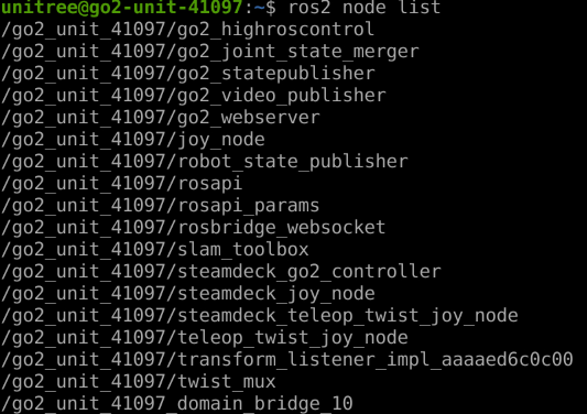

Could you share a screenshot of ros2 node info of all the running ros2 nodes.
Here is the screenshot
Screenshot from 2025-11-20 10-00-41

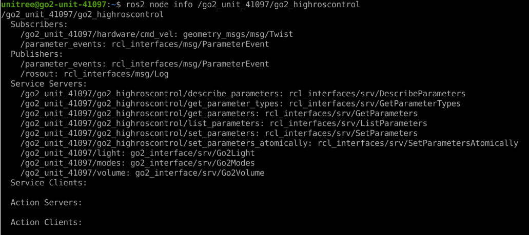

Could you post a screenshot of ros2 info of go2_highroscontrol?

THere are no actions for main driver only services.
