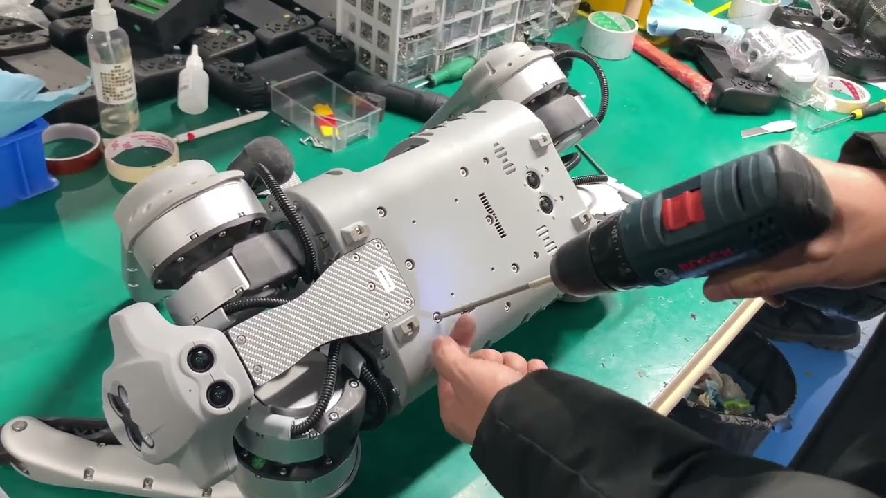

Dear @bpousett
It seems as if there cables of the main powerboard have become loose due to the jump test and now it’s shutting off randomly. I would suggest opening the robot and checking the internal wiring(i.e. unplugging and replugging the wiring)
you can follow the attached video for opening the robot from the top.
