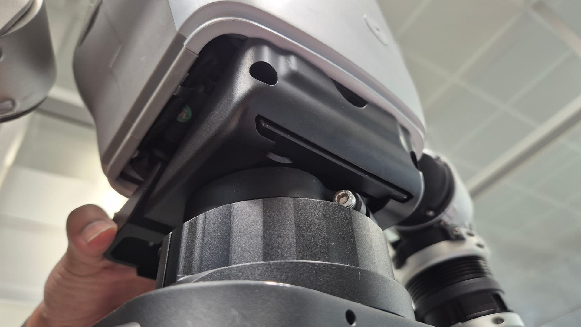

we are having troubles mounting the calibration waist mounts to our G1 EDU (s. images attached).
The chest plate of the robot is blocking the waist mount/ the waist mount can not be put under the chest plate.

yes i had the same problem during the first calibration. We needed a second person, that was readjusting the front mount, so that the back mount was able to slide in place. It is a real struggle.
