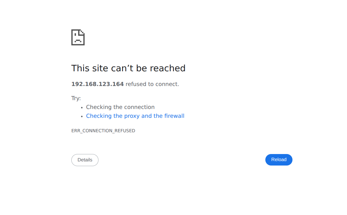

Hi everyone,
after finishing the installation steps for G1 I wanto to try the WebServer to activate another services, but the page always show “site can not be reached” as shown below:

Hello,
This issue is due to the qre_g1 webserver not being properly cloned and/or the libwebserver.py not having execution privileges.
For the second one solution is to:
cd /opt/mybotshop/src/mybotshop/g1_webserver/g1_webserver
sudo chmod +x *
Hi, quick question, Where can I download the qre_g1 webserver? I re-flashed the Jetson Orin
Provided that you have access from here
https://github.com/MYBOTSHOP/qre_g1
If you do not have access, send your order number with your github username to support@mybotshop.de and they will give you access.
Thank you for the reply, I don’t have access yet but will email the support right now!
I have the same problem. It seems that the file “libwebserver” doesnt exist. Where can i get this file?
Hi,
It seems in old version of repo qre_q1 this lib file is missing. You can contact the support team (You can find the contact in the comment) and get the latest version of this repo. After re-Building/installing all packages the Webserver and RemoteDesktop will work as described.
Best regards
