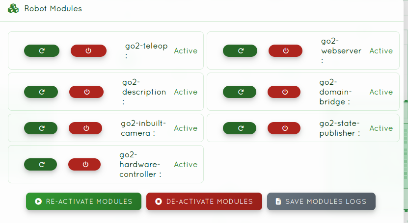

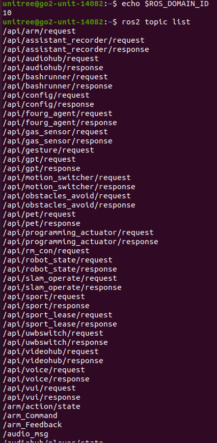

1.The ros2 topic in ROS_DOMAIN_ID=10 are the same with default ROS_DOMAIN_ID(already actived all the modules in web-server and ros2 launch go2_navigation slam.launch.py):

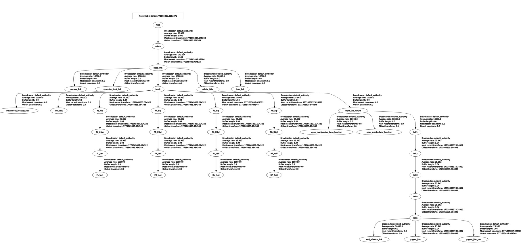

2.the TF tree seems to be normal(ROS_DOMAIN_ID=10 ros2 run rqt_tf_tree rqt_tf_tree --force-discover --ros-args --remap tf:=/$GO2_NS/tf --ros-args --remap tf_static:=/$GO2_NS/tf_static) :

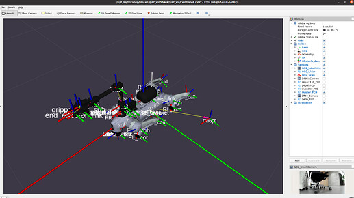

3.only the robot shows in rviz(ros2 launch go2_navigation slam.launch.py+ ros2 launch go2_viz view_robot.launch.py):

Currently, the nav2 and slam modules are not ported to the latest namespace changes. We will be updating the qre_go2 navigation module this month for it to work with it.
The issue is just namespaces and tfs if you need to correct it yourself.
