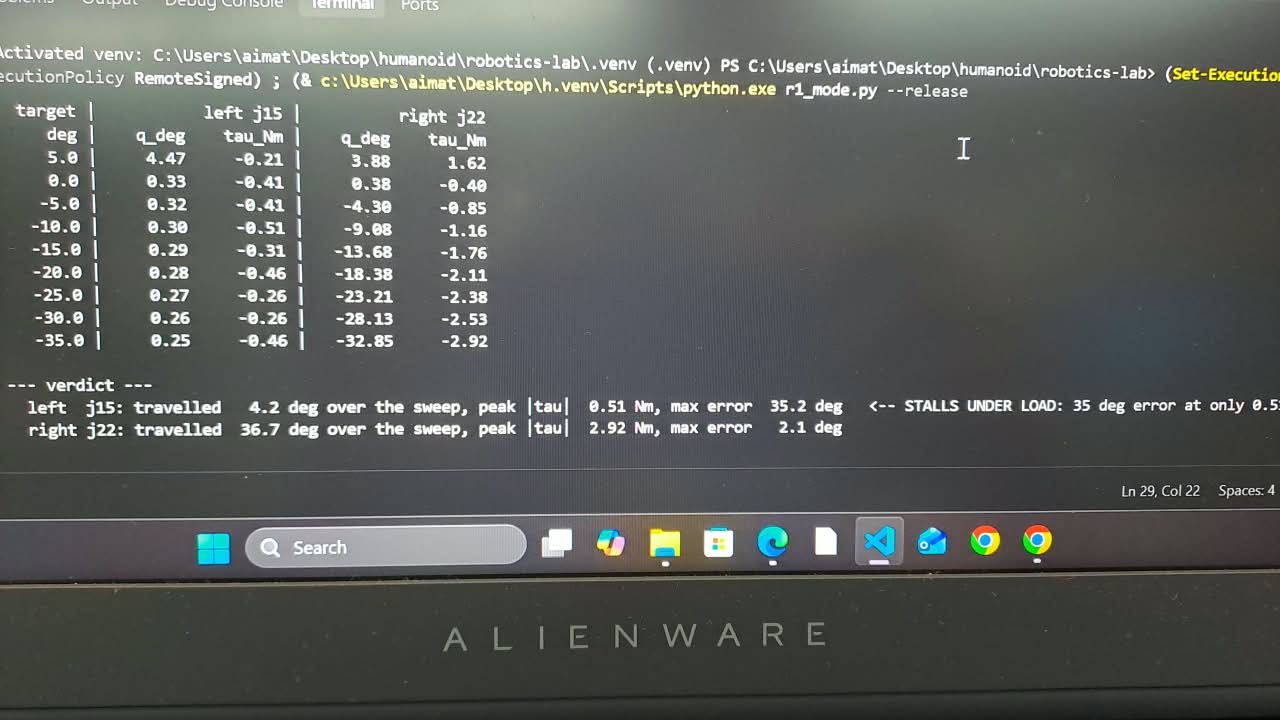

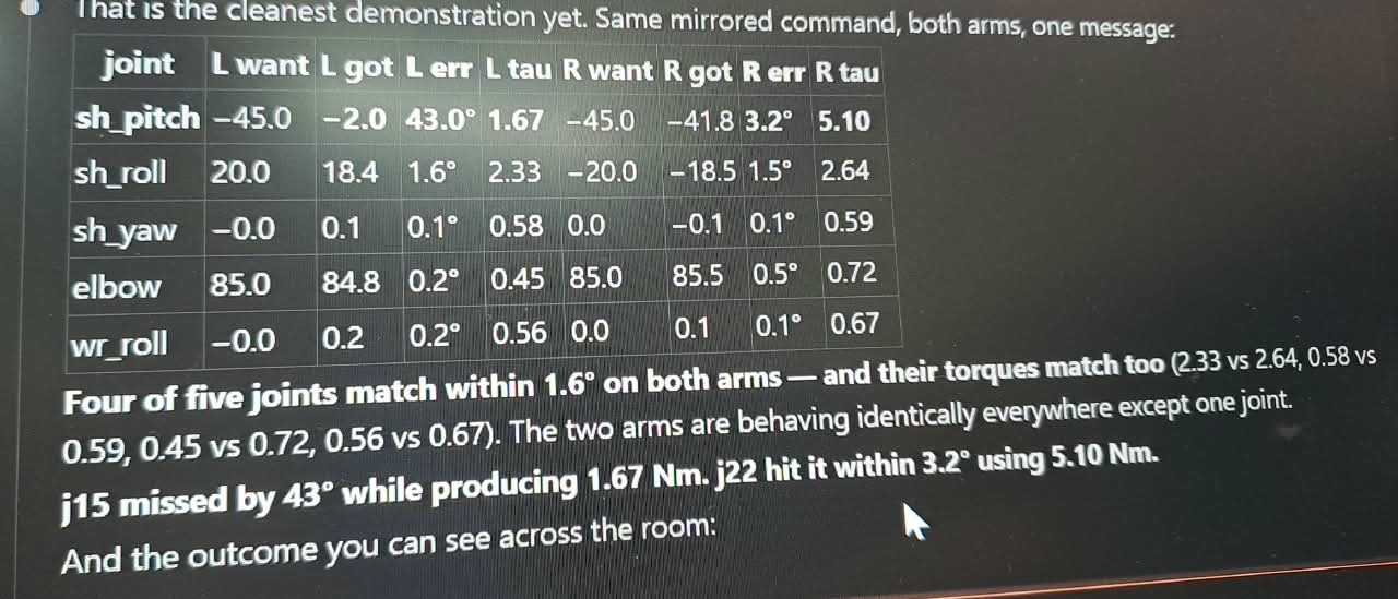

The right arm is working perfectly, but we are experiencing a significant issue with the left arm. When the left arm tries to extend forward, we hear noticeable vibrations and mechanical/screeching sounds coming from the left shoulder, specifically around joint J15. The arm also produces strong jerks during teleoperation, making it difficult to perform the task properly.
We have attached a video demonstrating the issue, where the noise and vibration from the J15 joint can be clearly heard. We have also attached the data/logs from our programming-mode tests, which show the joint behavior and help identify J15 as the problematic joint.
Based on our observations, we suspect that this may be a mechanical issue with the J15 joint or its motor/gear mechanism, rather than purely a software or teleoperation issue. However, we would appreciate your assessment to confirm this.
