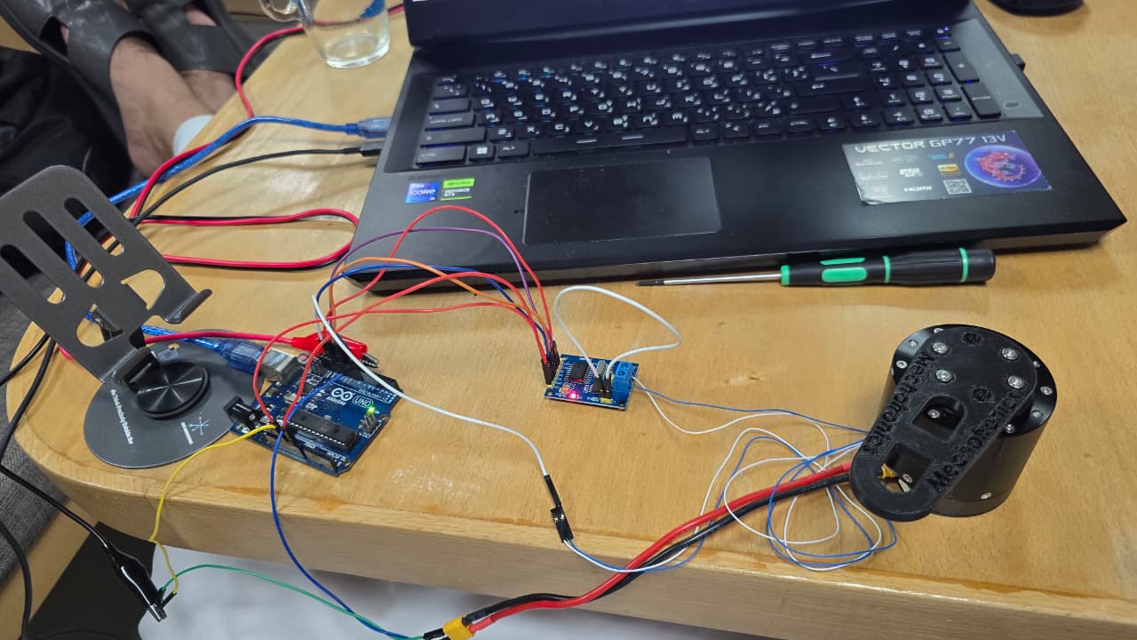

  1. Here are the pictures :
    And a list of the connections :
    INT <-> D2
    SCK <-> D13
    SI <-> D11
    SO <-> D12
    CS <-> D10
    GND <-> GND
    VCC <-> VIN
    CANH <-> CANH
    CANL <-> CANL

Indeed it worked, the problem was the CS pin and I also added two 120 Ohm termination resistors between CAN H and CAN L.
Now it works so it’s perfect.
