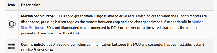

The both services are green and these both buttons are green correct?
yes, both M and <> button are green
